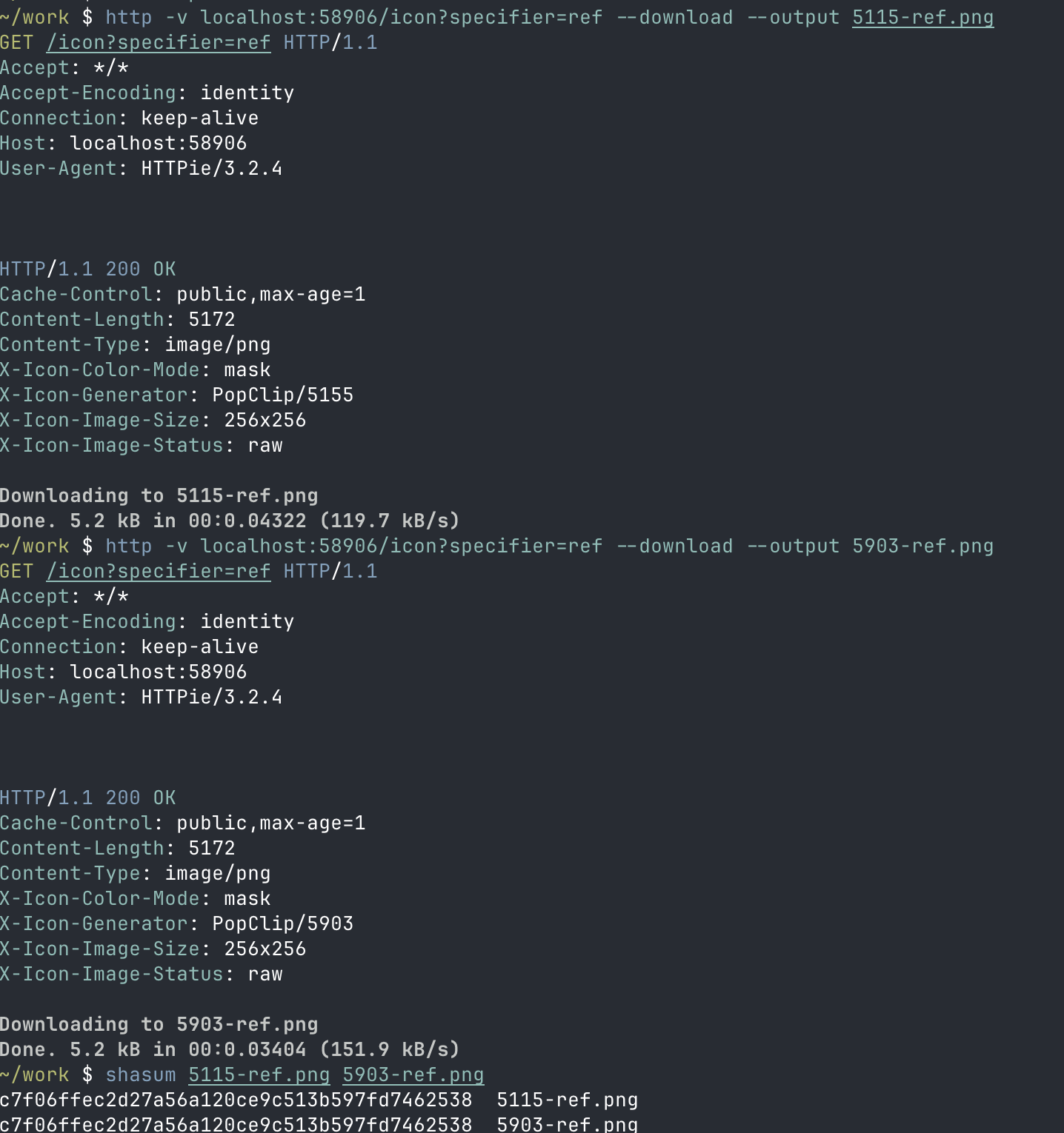

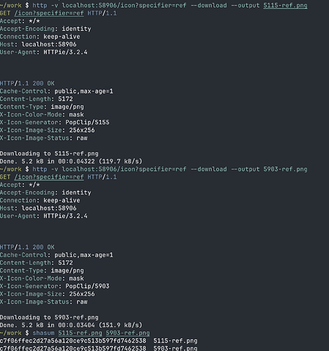

Yes, the rendering of the text icons in the beta is identical to that in the previous PopClip version 2025.9.2. A pixel exact match.
I verified this using PopClip’s built in icon server, accessible at http://localhost:58906/icon?specifier=<specifier> while PopClip is running.
Running 2025.9.2 and then Build 5115, the output PNG file was byte-for-byte identical.

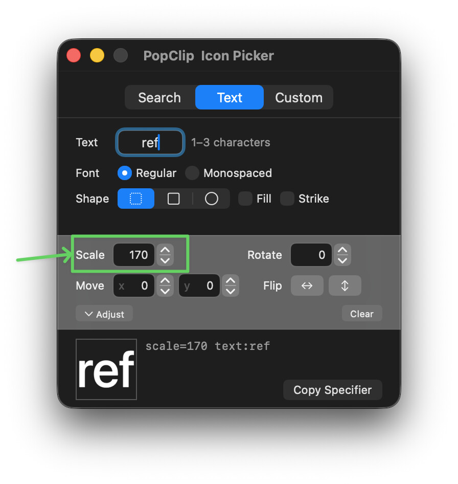

@Kolkrabe However, if the text is too small, you can just scale it up like this:

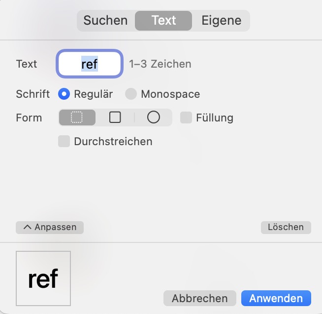

This is weird. Setting a text icon always gave me a perfectly readable text in the PopClip bar, now it is tiny and needs manual adjustment.

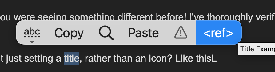

Are you sure you weren’t setting a title, rather than an icon? Like this:
e.g.
action:
  title: "<ref>"
  javascript: popclip.showText("something to do with refs :)")
