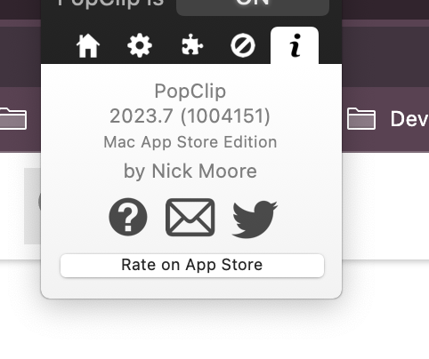

@tony42 what version of PopClip are you using?
CleanShot 2023-08-28 at 07.06.45@2x
