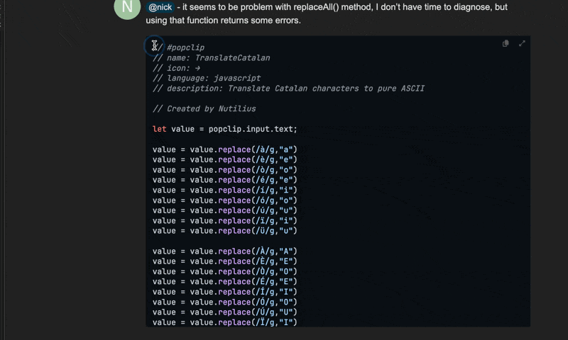

Below is simple implementation. Select text, call translation and text will be replaced with replacement.
@nick - it seems to be problem with replaceAll() method, I don’t have time to diagnose, but using that function returns some errors.
// name: TranslateCatalan
// icon: →
// language: javascript
// description: Translate Catalan characters to pure ASCII
// Created by Nutilius
let value = popclip.input.text;
value = value.replace(/à/g,"a")
value = value.replace(/è/g,"e")
value = value.replace(/ò/g,"o")

popclip.pasteText(value);

Hi @franctastic, to install the extension, you select the text and then click the button that appears like this:
CleanShot 2026-03-13 at 07.23.17
And also adjust the extension yourself, for example, to change the name, or I think you can see in the code where you can remove lines or change which characters are replaced.
