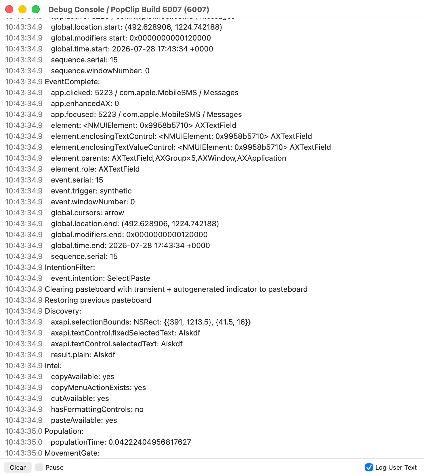

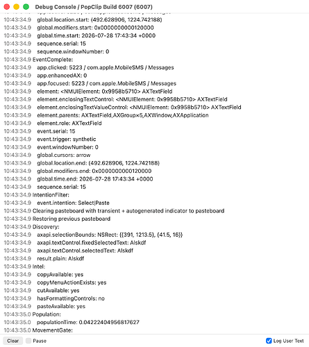

Which brings me to the thing I noticed in the debug console (screenshot attached). A normal sequence ends like this:
10:35:03.6 Population: populationTime: 0.058 10:35:03.6 MovementGate:
MovementGate: is the last line, nothing indented under it, and then the next thing in the log is a completely new user action. Population is only taking 58ms so nothing’s slow up to that point.
I want to be careful here though, because I captured 8 of these sequences and every single one ends at MovementGate: the same way. So this might just be where the logging stops rather than where anything’s actually stuck. I can’t tell from outside the app and I don’t want to send you off chasing something that’s just the end of the log.
The reason I’m mentioning it anyway is the name. If that stage is waiting on pointer motion events to arrive, it lines up exactly with what I’m experiencing, because on a stationary trackpad those events never come until I wiggle.
The one thing I haven’t been able to test is mouse vs trackpad. I don’t have an external mouse. My assumption is that a hand resting on a real mouse produces constant tiny movement that a lifted trackpad just doesn’t, and that would explain why you can’t reproduce this, but I haven’t actually verified that so take it for what it’s worth.
So I guess my question is whether MovementGate depends on receiving motion events. If it does, is there any chance it could also open on a short timeout, or hit-test NSEvent.mouseLocation when the popup gets shown, instead of needing a motion event that a stationary trackpad won’t send?
Happy to run any test build or extra logging if that’d help. Setup is a MacBook Pro M5 Pro, macOS
26.5.2, PopClip build 6007, built-in trackpad only.
