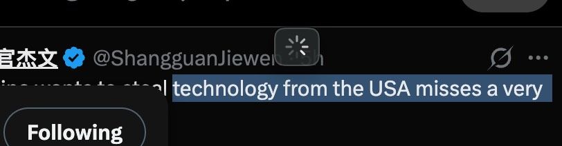

Long delay while waiting for browser to open new tab

Highlight text, click/activate Google Translate, Tiny hourglass right at the PopClip location for ~15 sec, eventually the new Google Translate tab opens with highlighted text.

Oh, I see, that’s an instance of the browser JavaScript issue where browsers sometimes freeze when PopClip asks them to open a new tab.
Quit/restart browser or re-installing the browser may fix it.
Otherwise, this is the defaults command you want:
defaults write com.pilotmoon.popclip DisableBrowserTabScripts -bool YES
