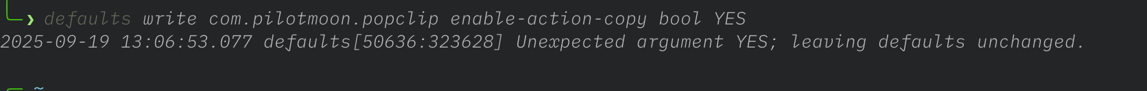

OK I’m getting closer to the problem… New plan! Please run command in Console:
defaults read com.pilotmoon.popclip
And send me the output.
OK … I think I have an answer. I think you might have all your actions disabled except for Spelling?

I got this when run the command
Oops!
Correct command is:
defaults write com.pilotmoon.popclip enable-action-copy -bool YES
It’s working well now , Thank you very much :heart:
