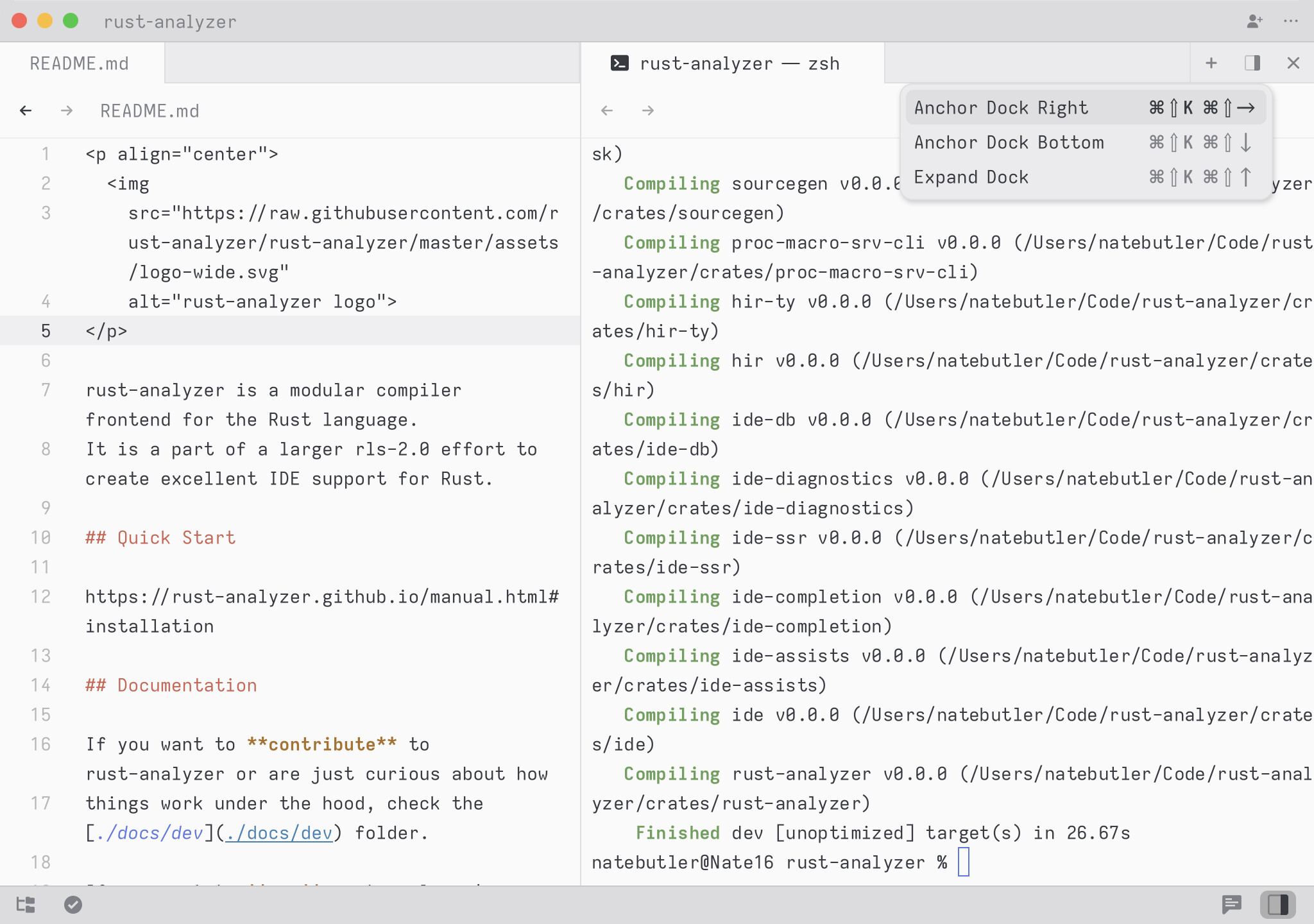

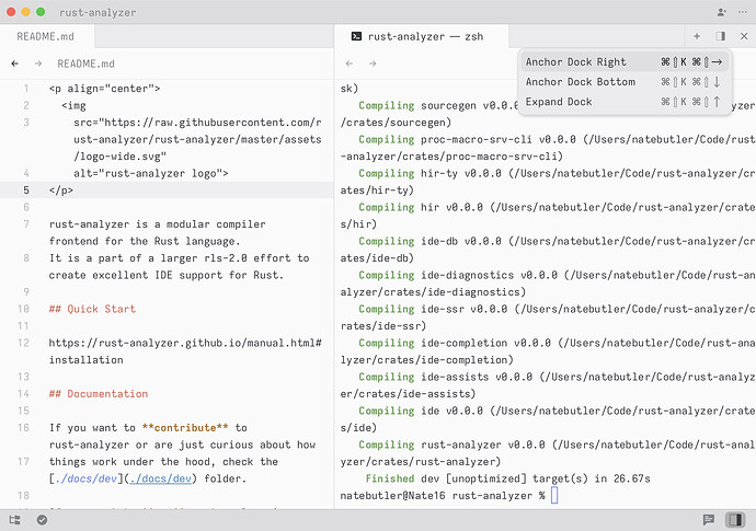

PopClip works fine in Zed, but the popup won’t show up when selecting something in Zed’s terminal:
Wonder if this a bug?
