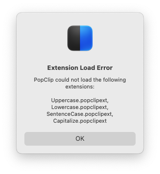

Hi, I can’t install the extensios:
Uppercase
Lowercase
The version of PopClip is the latest:
PopClip Build 5898 (5898; 2 Jul 2026)
Standalone Edition - Beta
Help, is important to me, use this extensions.
How to?
Uppercase
Lowercase
How to?

I just installed the beta, and was presented with this message. Haven’t had time to investigate yet, but first thing is to re-download and reinstall the extensions.
Thanks. Yes, re-adding and re-installing the extensions will fix it. There’s an issue with really old versions of some extensions that are “non compliant”.
Going forward, automatic updates for extensions will solve this stuff.
I’ve got some ideas how to solve this for the beta too, because these errors are annoying! Thanks for reporting.
