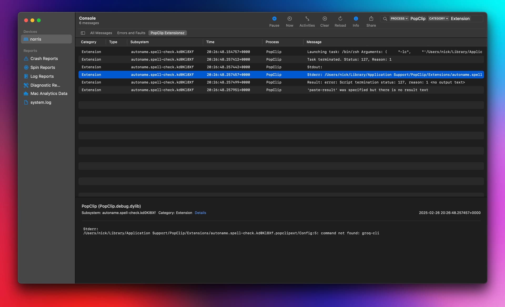

I’m sure we can get to the bottom of it together. To start with, I suggest enabling extension debug output so you can view any error output from the script in the Console, as per Debug output.
As an example, the screenshot below shows what I get when I run your snippet. However, I do not have a groq-cli command in my path so this error iis to be expected in my case (I web searched it, but there seem to be many things called that, so I didn’t go further.)

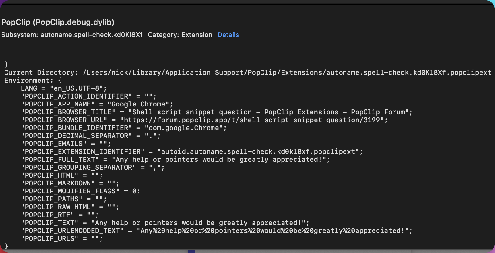

You can check the exact value of POPCLIP_URLENCODED_TEXT in the Console under the “Launching Task” entry:

What I sent you is what the console app showed for the error. I see the same truncating in the “Launching Task” entry which leaves off the POPCLIP_URLENCODED_TEXT entry.
