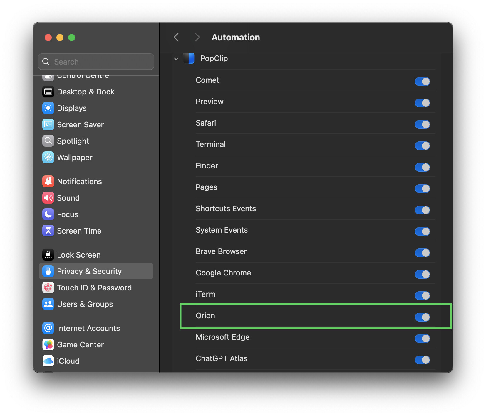

Can you check in System Settings → Privcacy & Security → Automation and see if Orion is enabled under PopClip section?
Yes, Orion is enabled under PopClip. I also tried turning it off and on again and relaunching both apps, but it didn’t help.
