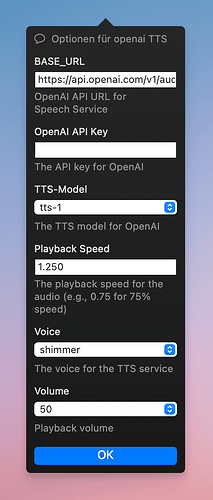

A user has created an implementation for OpenAI at the following link: popclip-openai-tts/openai_tts.sh at main · YuChenSSR/popclip-openai-tts · GitHub. Unfortunately, the script contains a syntax error.
I have fixed the script and also added several additional options.
#!/bin/zsh
# #popclip
# name: openai TTS
# icon: symbol:message
# options:
# - { identifier: url, label: BASE_URL, type: string, default value: "https://api.openai.com/v1/audio/speech", description: "OpenAI API URL for Speech Service" }
# - { identifier: api_key, label: OpenAI API Key, type: string, description: "The API key for OpenAI" }
# - { identifier: tts-model, label: TTS-Model, type: multiple, values: [tts-1, gpt-4o-mini-tts], default value: "tts-1", description: "The TTS model for OpenAI" }
# - { identifier: speed, label: Playback Speed, type: string, default value: "1.250", description: "The playback speed for the audio (e.g., 0.75 for 75% speed)" }
# - { identifier: voice, label: Voice, type: multiple, values: [alloy, echo, fable, onyx, nova, shimmer], default value: shimmer, description: "The voice for the TTS service" }
# - { identifier: volume, label: Volume, type: multiple, values: ["10", "20", "30", "40", "50", "60", "70", "80", "90", "100"], default value: "50", description: "Playback volume" }
# Create a temporary variable for input and clean it
input_content=$(echo "$POPCLIP_TEXT" | tr '\n\r' ' ' | tr -s ' ')
# Create a unique temporary file in the system's temp directory
temp_file="/tmp/popclip_tts_$_$(date +%s).mp3"
# Store current volume
current_volume=$(osascript -e "output volume of (get volume settings)")
# Use curl to download and save the audio data to the temporary file
curl "${POPCLIP_OPTION_URL}" \
-H "Authorization: Bearer ${POPCLIP_OPTION_API_KEY}" \
-H "Content-Type: application/json" \
-d '{
"model": "tts-1",
"input": "'"${input_content//\"/\\\"}"'",
"voice": "'"${POPCLIP_OPTION_VOICE}"'"
--output "${temp_file}"
# Set volume for playback using the PopClip option
osascript -e "set volume output volume ${POPCLIP_OPTION_VOLUME}"
# Play the temporary audio file using afplay at the specified speed
afplay -r ${POPCLIP_OPTION_SPEED} "${temp_file}"
# Restore original volume
osascript -e "set volume output volume ${current_volume}"
# Clean up the temporary audio file when you're done with it
rm "${temp_file}"

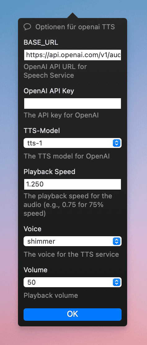

@nick PopClip runs for as long as afplay is active and playing the file. Is there a way to close PopClip earlier while allowing afplay to continue playing? During this time, PopClip isn’t usable - it can only interrupt the playback of the MP3 file.
Yes, in a shell script you can put & at the end of a command to run that command in the background and PopClip will then not wait for it. So:
afplay -r ${POPCLIP_OPTION_SPEED} "${temp_file}" &
I’ve already tried that. PopClip keeps spinning until the sound output has finished. The following commands are likely the source of the problem. ![]()
Okay. Diese Zeile funktioniert:
nohup sh -c "afplay -r ${POPCLIP_OPTION_SPEED} '${temp_file}'; osascript -e 'set volume output volume ${current_volume}'; rm '${temp_file}'" >/dev/null 2>&1 &
