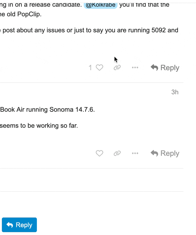

When the settings panel is open and you click the menu entry Settings again, the settings window bounces up for a moment. This is likely intended to steer the focus on the already opened window. There is a small visual glitch however, as every few times when opening the settings panel the window bounces up for a moment (see video below). I couldn’t spot any pattern however.
CleanShot 2025-09-04 at 21.57.01
