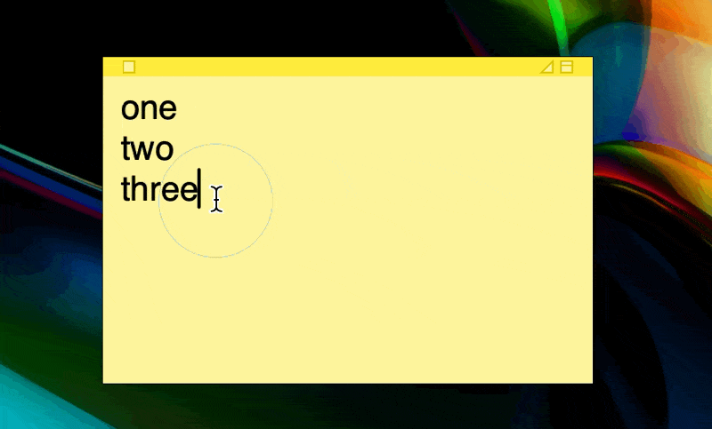

To perform the transformation while copying, hold the Shift key when performing the action on the source text and it will copy the modified text to the clipboard.
Example:
CleanShot 2025-10-22 at 08.30.12
