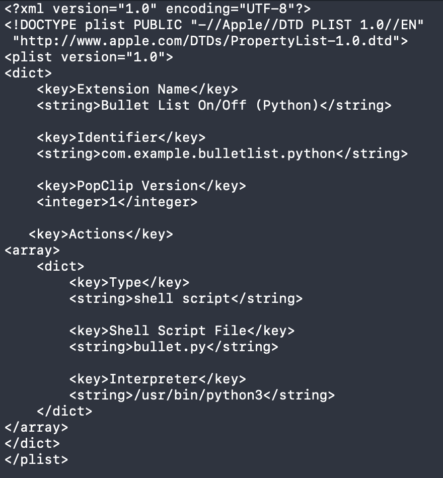

Hi all,
Just for fun, I tried to create a popclip extension that would add bullets if none and remove them if present.
I got the extension to load into popclip, but nothing happens when I click the extension. I have Python 3 installed on the Mac.
I’m also not sure how to create an icon instead of the title being displayed.
Plist

Hi Mike,
Awesome to be experimenting with extensions!
You are also using quite an old style of extension with the plist and the separate Python script in a package.
Because you posted it as quoted text rather than code, it was difficult for me to read the Python directly.
I won’t engage with the Python since I’m crap at Python anyway.
There is an easier and more modern way of doing things, which is to use a javascript snippet, which I’ll demonstrate below:

(The above block is an extension snippet — select it then click “Install Extension” in PopClip.)
I can’t claim credit for the actual code above because I had Codex 5.5 write it. It’s a nice bit of code though!
